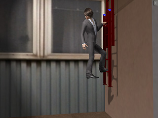

The original pose of the actor

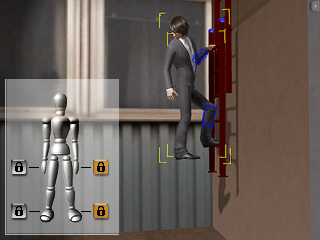

  1. Right-click on the actor and select Motion Menu/Edit Motion.
  2. In the Edit Motion Layer panel, click one or more of the Lock icons to set the desired bone to be locked.

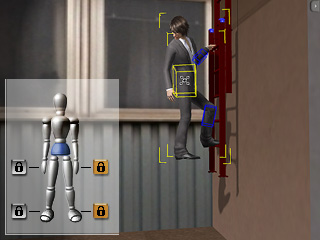

  1. Pick one of the bones that you want to move by the IK operation. In this example, the pelvis bone.
The pelvis bone is selected for moving
while the actor's left hand and foot are locked
in position.

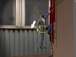

Move the bone to see the result.
