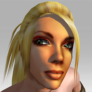

Original Appearance

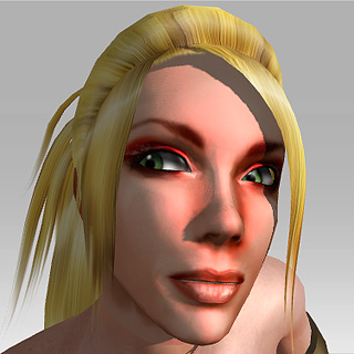

Diffuse Color:
(Adjust the skin color)

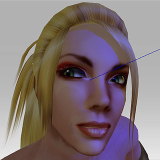

Specular Color:
(Create the suntan effect)
  • You have to increase the value of the Specular to see the color effect.

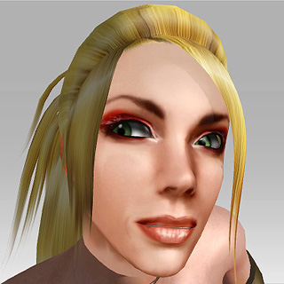

Diffuse color:
Self-illumination: 100
  • It is very easy to create a cartoon look by using the Self-illumination feature.
  • The Light color is white in this example.
  • The Diffuse color is totally ignored as the value is 100.

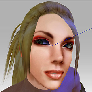

Light color:
  • The Light color is totally ignored as the Self-illumination value is 100.
  • When the light effect is ignored, the shadow effect will decrease as well.

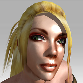

Create Oily or Wet Look Face
If you plan to create an actor with oily or wet look face, you need to adjust two parameters: Specular and Glossiness.
Specular reflection is the mirror-like reflection of light from the head, in which light from a single incoming direction is reflected into a single outgoing direction.
Glossiness is based on the interaction of light with physical characteristics of a surface. Materials with smooth surfaces appear glossy, while very rough surfaces appear mat.
Specular: 10
Glossiness: 10
Specular: 100
Glossiness: 30
