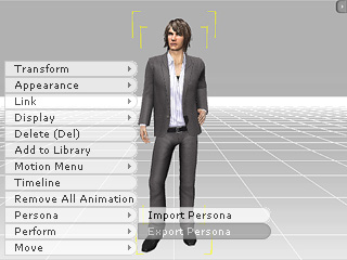

Export and Import Persona
You may export the persona of a specific actor, modify the content of the file and apply it to the original or another actor.
To export a persona, you may:
