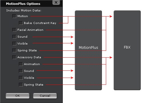

Although MotionPlus contains many types of data, when you want to export it into FBX format, some data unsupported by FBX will be ignored and removed from the file. Meanwhile, the motions or animation related data will be baked and flattened to the bones (please also refer to the Icon in Motion Library section for more information):

To sum up, the motion data flow from iClone to FBX can be shown as the illustration below:
(Please note that the character's voice is includable in MotionPlus but will be removed when being exported
into FBX)
