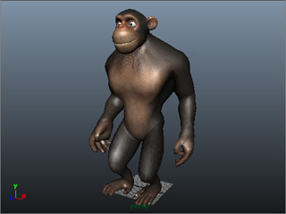

The initial look of a non-standard character, and the new look after body proportion is adjusted
in iClone.

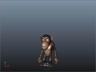

The look in Maya after the character is exported
in FBX via 3DXchange.

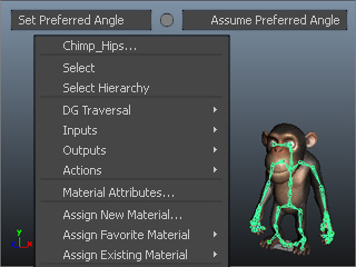

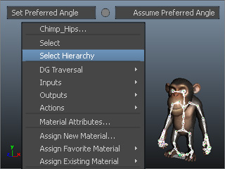

Select the bone root and click the right mouse button.
Choose the Select Hierarchy command to select the entire bone structure.

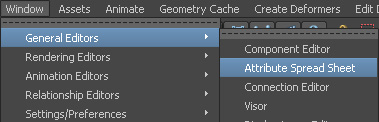

Execute the Window >> General Editor >> Attribute Spread Sheet command to show the corresponding panel.

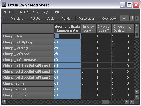

Turn off the Segment Scale Compensate by keying "0" to the column for each and every bone joint in
the Attribute Spread Sheet panel.
Freely scale the parent or root bones and resize to change the body trunk or limbs
to ideal sizes.
