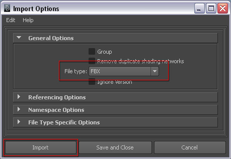

Select the File >> Import >> □
command.
Make sure the File type in the General Options
section is set to FBX and click the
Import
button.

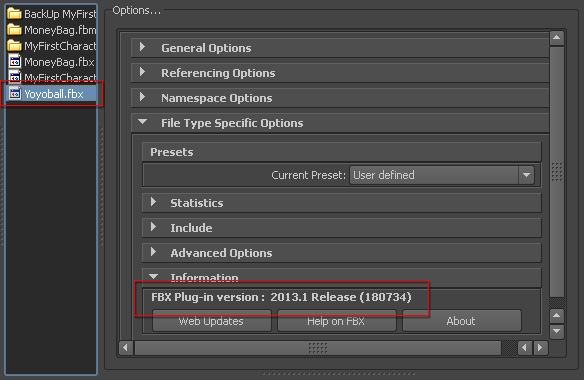

Select an FBX file and check out the FBX Plug-in Version at the bottom of the Option group.
If you find the version is too old, then please
upgrade your Maya
to include the latest FBX version.

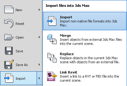

Go to
>> Import >> Import.

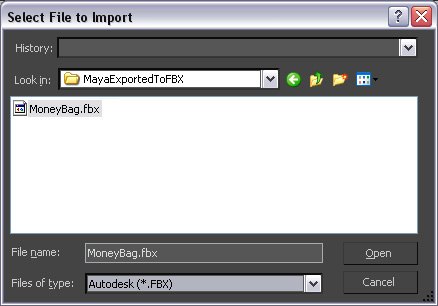

Select an FBX file, set the Files of type to
Autodesk (*.FBX) and click the Open button.

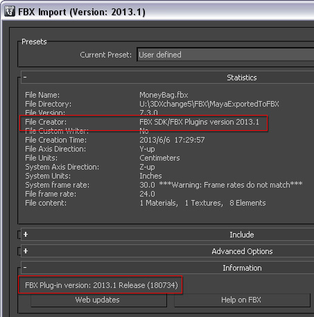

You will view the FBX Plug-in version in two places in the coming dialog box.
upgrade your 3ds Max
