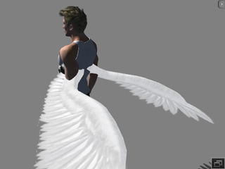

The wing rotates after being applied.

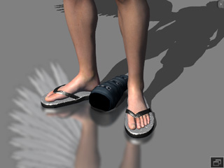

The arm bracer is attached to the root of the character after being applied.

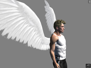

    The wing's direction is rectified.

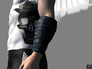

    The arm bracer is attached to the forearm.

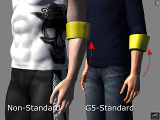

    • If the accessory can not find its originally assigned target bone, then it will be attached to the bone one level higher than the target bone.

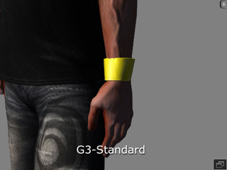

    The wristband is attached to the Twist Bone of a G3 Standard character.
    When being applied to a G5 Standard or Non-Standard character without the Twist Bones, the accessories will be attached to the forearm bones (one-higher level) instead of the roots.
