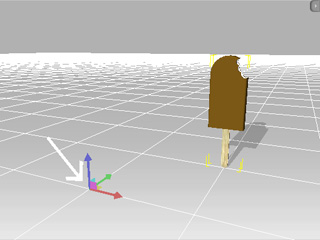

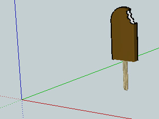

After you create an object via your favorite 3D softwares (such as SketchUp), the pivot is generated automatically. In general, the pivot is set to be located at the origin. Therefore, if you create your object away from the origin, the pivot of it will be eccentric. iClone also loads objects with their pivots align to the world axis if you double-click to apply them.
Create Model in SketchUp. The pivot of the model is set at the origin. |
Double-click to load the model. The pivot aligns to the world axis. |

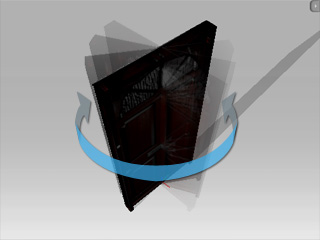

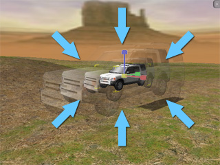

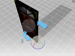

Since the pivot is the base for the transform data to refer to, the Move, Rotate and Scale work according to the pivots of objects. If a pivot is outside of the model entity, the unexpected result happens, especially Rotate and Scale, when you adjust the transform data of the object.
Move |
Rotate |
Scale |

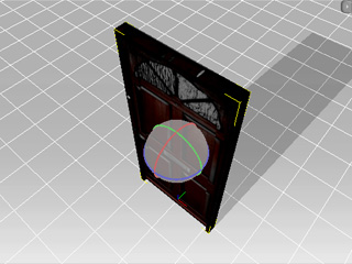

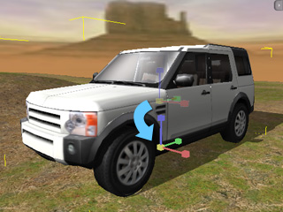

You might come across models that have eccentric pivots. In iClone, you may freely change the pivot of the selected object without the use of any external software.
Please select the target prop and toggle the Gizmo mode (Ctrl + Q) to view the position of the pivot.
This method is suitable for props that revolve on their own axis or scale from their own center. (e.g. tire)

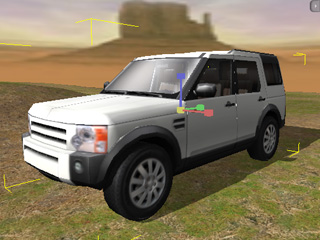

If you want to set the pivot to the mesh center of the selected prop while the prop is set to a designated position already, you may use this method.
The pivot of the pinwheel is out of its mesh |
The pivot is relocated to the Mesh Center |

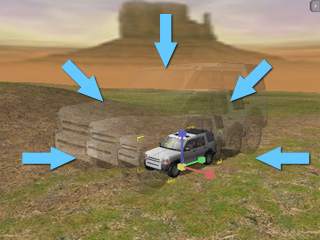

Basically, the pivot of a general prop shall be set to the bottom center so that it can follow the terrain. If the pivot is set to the bottom center, once it is scaled, the mesh can be resized without offsetting it from the terrain.
Pivot at the center |
Set Pivot to bottom center |

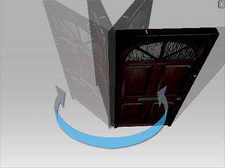

If you want to create a prop that has revolutionary orbit around another target, this method is the appropriate approach. (e.g. planet or door)
You may use this method to set the pivot of a prop elsewhere:
Select a prop for relocating its pivot.
Move the prop away from the origin.
Click the Scene Root button.
The pivot of the prop is re-located to align to the scene root.
Move the prop and set Pivot to scene root |
