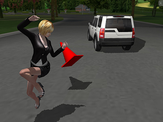

Self-Cast Shadow (Directional Light)
Self-Cast Shadow (Spotlight)
The Shadow is turned off.
The Shadow is turned on with directional light.
A realistic way to calculate the physical
projection of shadows from the light source via the shadow map technology.
Cast and receive shadows both from
characters and props/scene.
Shadows can be cast on the source's own surface as well.

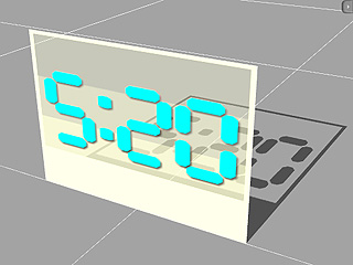

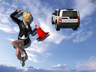

Drop Shadow
Wall Shadow
A quick way for objects to drop shadow
Only on the virtual floor (X-Y plane) or 2D
background but not on any other 3D objects.

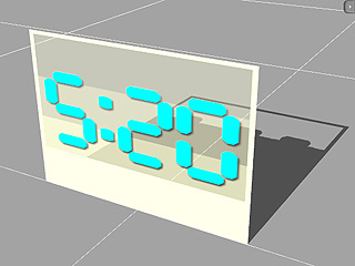

Wall Shadow will create a 2D shadow
effect by offsetting a shadow directly
behind objects. If you select this option,
the Offset X, Y will be enabled for you to
define the position of the shadow.
Please note that the Wall Shadow is cast
merely on the 2D Background and Sky
and not on the Terrain.

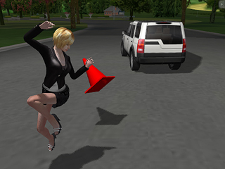

More about Self-cast Shadow

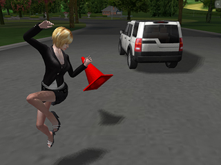

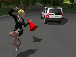

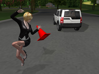

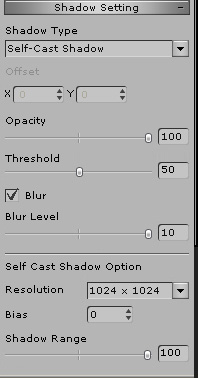

Shadow Opacity
Adjust the Opacity value to define the transparency of the shadow. In general, stronger light (especially directional lights) will cast higher opacity shadows.
Opacity = 60
Opacity = 100

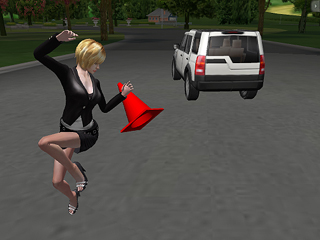

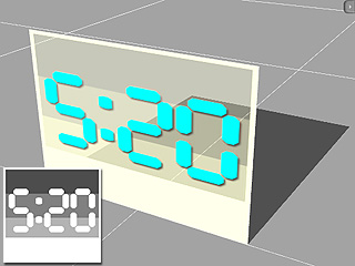

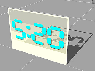

Threshold
The Threshold sets decides the level of transparency that is required to cast shadows.
Object and its Opacity texture
Threshold = 30
Threshold = 50
Threshold = 70

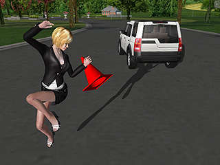

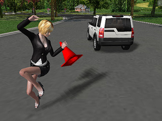

Blur
Check the Blur box to enable this feature. Adjust the Blur Level to define the edge softness of shadows.
Blur Level = 1
Blur Level= 10
