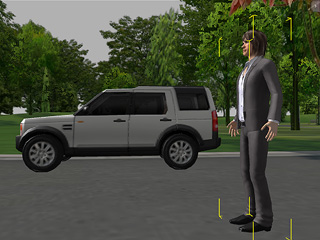

You may have your actor interact with the iProp through two methods as it is recording:
Press down and hold the Ctrl key, and then Single-click on the desired iProp that you want the actor to interact with.
This method triggers the default interaction for the two objects involved.

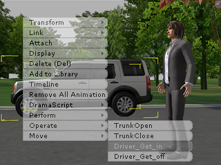

Alternatively, you may right-click on the iProp to pop up its Right-click Menu. Select any sub-command in the Operate entry.

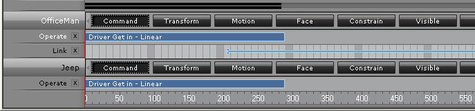

The motion and animation clips will be stored into the Operate tracks individually as the interaction finishes. These two tracks store the motion of the actor and the animation of the iProp. (The play bar displays the actor-related tracks only.)

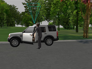

In the Editor Mode, you may also add motion/animation clips into the Operate tracks. However, you can only achieve this goal by using the Right-click Menu.
In the Editor Mode, click on the actor for interacting.

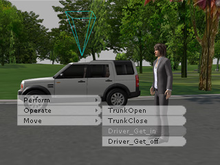

Right-click on the desired iProp.

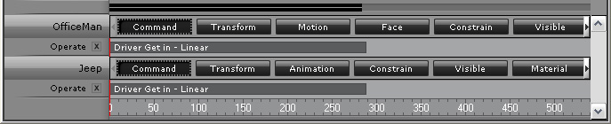

The motion and animation clips will be stored into the Operate tracks individually. (The play bar displays the actor-related tracks only.)

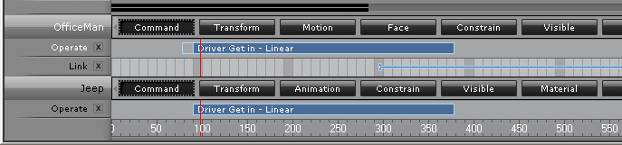

When you click on the clips or keys generated by the Operate command, all the tracks of the related clips or keys (highlighted automatically) show up.
Drag a clip or key mentioned above and all other related clips or keys will be moved in synch to prevent chaotic results.
