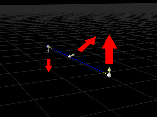

Every control point has its own arrow pointer. These points refer to the direction that the prop or the character will be facing when it reaches the control point.
Control Points Direction

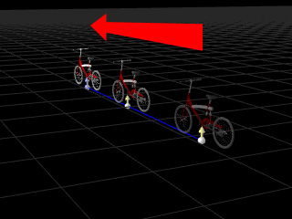

If you have all the Control Points facing one direction, you may get the following result.
Result

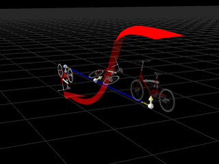

Turning Control Points
By modifying every control point you can make a prop turn on a selected path. You may enable the Edit Path button to select the control points and turn its direction.

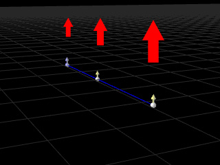

  1. Create a path and have the path in selection.
  2. Go to the path's modify panel and enable the Edit Path button.
  3. Select the pointer and press the right mouse button to turn its direction.
