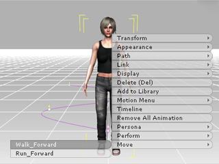

There are two ways to enable your characters to walk on a path you have designed. You may simply direct them to walk on a target path using the behavior mode in right menu.
  1. Create a path for your character to walk on.
  2. Add a character into the scene.
  3. Right-click on the character and select Move > Walk_Forward.
  4. Pick the path you have just created. The character will walk to and then right along the path.
