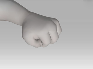

Hand gestures can be created within minutes, no matter if you need to hold a fist or create a gesture with fingers.

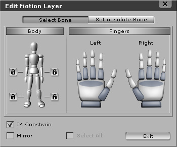

In the Motion Modify Panel, click Edit Motion Layer.
The Edit Motion Layer window appears for you to control.
Focus to the character's hand.

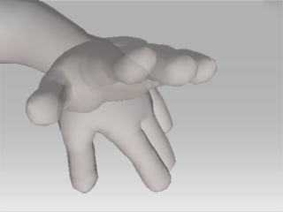

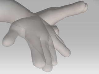

Rotate the wrist.
Dragging |
Result: Rotating Wrist |
Dragging |
Result: Bending Wrist |

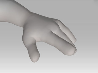

You may also curl all the fingers all at once by dragging the palm control.
Dragging Up |
Result: Fingers Curl Outward |
Dragging Down |
Result: Fingers Curl Inward |

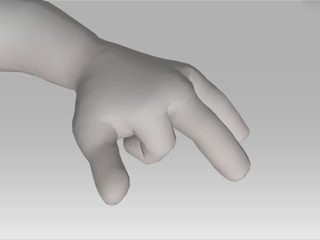

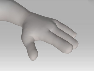

Press and drag the dummy's dark grey part of the fingers to set gestures.
Dragging Up |
Result: Finger Curl Outward |
Dragging Down |
Result: Finger Curl Inward |
