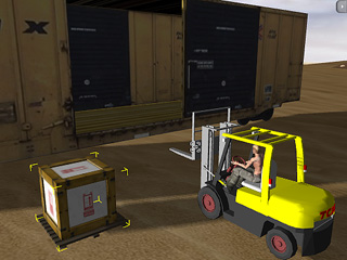

Drag and drop the desired prop(s) into current project.
Double click on the prop to pick it.
Drag and drop the crate
Scroll to the Linkage section and click Pick Parent button.
Navigate on the 3D viewer and click on the target object. The prop may be still at the wrong position.

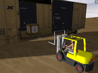

Pick the lifter of the forklift as the parent of the crate
Adjust the position of the prop for better placement if necessary

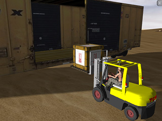

prop then will be forced to align to its parent.
The crater is aligned to the lifter
Move the parent object to test the result.

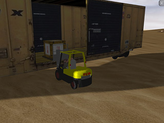

Click on the desired parent on the 3D viewer. Now the parent is changed.
The crater is now linked to the train.
Move the new parent object. The transform data of the prop will now be controlled by the new parent.

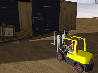

The train moves away with the crate
