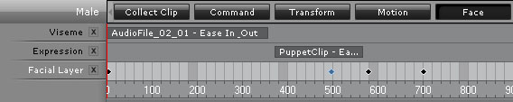

Facial Expression Tracks
Toggle the Face button on the timeline and the face tracks of the actor will show.

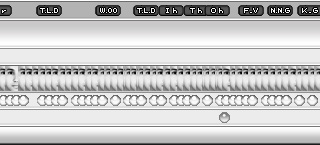

Viseme Track
The Viseme Track stores the lip-sync data of the character that moves the mouth.
The Data will be converted into clips in the Viseme Track and can then have its position adjusted to have your avatars speak at different times.
Expression Track
Facial Clips will be produced in the Expression Track when:
Once you have applied an Expression Style to the character you can set the Expression Strength of the character.
Facial Layer Track
The facial deformation keys generated from the Face Key panel are displayed in the Facial Layer Track. This track stores the unique G4 bone-based facial deformation data which gives rich facial details to iClone4 actors. Please note however that this data cannot be imported back to CrazyTalk.
