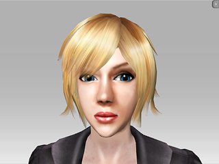

The Jaw Bone of CrazyTalk and iClone
The actors in iClone contain jaw bones to generate more realistic speaking facial motions, as well as the jaw bones for the avatar in CrazyTalk 6. So the actor may speak with open mouth and lower jaw instead of open mouth only. However, since the G1 and G2 actors do not contain a jaw bone, the jaw bone effect from CrazyTalk 6 may be ignored.

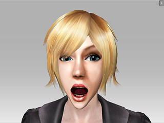

The avatar open mouth with
a down-moving jaw in
CrazyTalk 6.

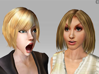

The G3 actor (left) opens her mouth with
a down-moving jaw while the G2 actor (right)
only opens her mouth slightly without moving
her jaw.
