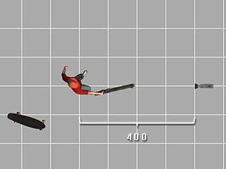

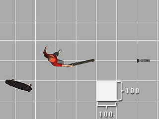

The default grid size is 100 cm x 100 cm. Therefore you may use the Top view of the camera to define the approximate Convergence Distance.

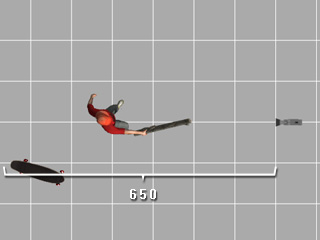

Convergence Distance = 650 |
In order to have an ideal 3D-viewing result, the recommended distance is where your main character or object is.
Convergence Distance = 400 |
