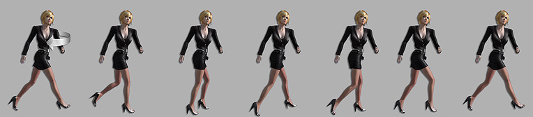

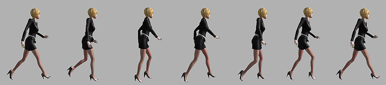

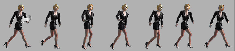

Suppose we have a motion clip loaded into the Perform track in which the data tells the actor to walk with a natural swaying of the body.

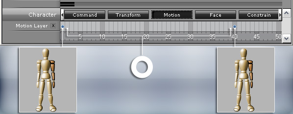

The Pure Key-Frame Motion means to generate motion only by keys in different frames. There is no other motion clips in another tracks.

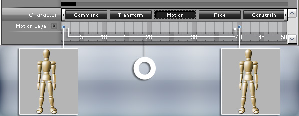

In this case, only the Transition Effect between two adjacent keys will be different in accordance with the status of these two keys. Here are the rules for the transition effect.
No transition effect between Absolute and Relative keys.
Transition effect is generated between Relative and Relative keys.
Transition effect is generated between Absolute and Absolute keys.
If we want to have the motion layer key affect the motion clips in Move, Perform or Operation tracks, we need to use both Absolute and Relative alternately.

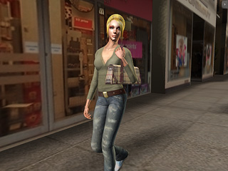

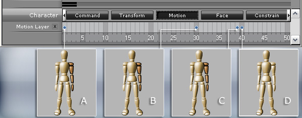

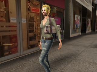

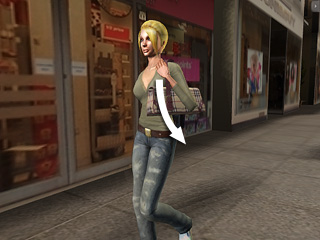

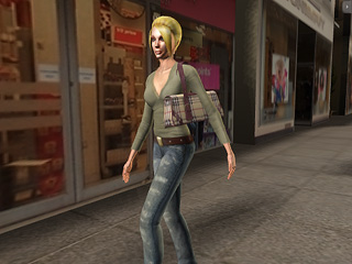

Given a lady walking on the street (Walking motion applied already in the Perform track), we want her to hold her bag with her left hand from frame 0 to 30 and to reach down and swing the hand naturally from the 40th frame, we need to do it as described in the following illustration.
A. Set this key Absolute so the lady's hand hold the bag without being influenced by the motion clip from another track. |
B. Since we don't want the lady to reach down her hand abruptly, we need to generate a transition effect from frame 30. |
C. Set both the keys in frame 30 and 39 Absolute will then generate a transition effect of stretching hand. The key in frame 39 is relatively crucial hereupon. |
D. Set the key in frame 40 Relative so her hand starts to swing along with the motion clip in another track. |
