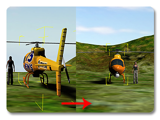

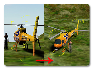

| Quick camera Positioning |
A - Left
S - Right
D - Back
F - Front
G - Top
H - Bottom
J - Face
K - All
Home - 45 Degrees |
Press F to switch the selected
object (character,
accessory, prop) face front .
Press Home to snap the camera
to the 45 degrees perspective to the selected object (character,
accessory, prop).
