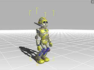

Since a CloneBone actor behaves totally the same as the standard actors, you may modify its motion the same as normal human actors.
Pick the CloneBone actor and right click on it.
Select Motion Menu/Edit Motion item in the right-click menu.
Select
or

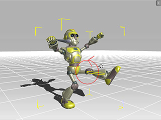

tools to utilize the IK or FK method to
modify the motion of the CloneBone actor.
Note: |
You may directly pick the specific bone node without being hindered by the props or accessories attached to it when you are using IK or FK methods. Please refer to the The Concept of Motion Layer Editing section for more information. |
