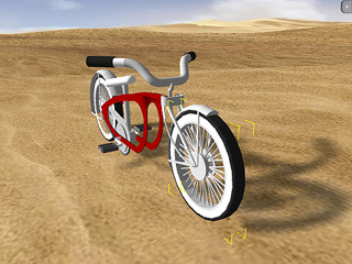

In the following example, the rare tire is attached already to the frame and inherits the move, rotate and scale data of it.

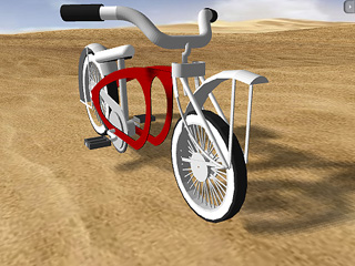

The front tire will now be attached to the frame while the Move/Rotate/ Scale boxes are unchecked individually.
Attach the front tire to the frame while |

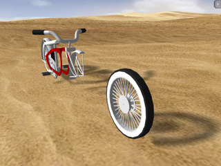

Move the frame away |
Rotate the frame |

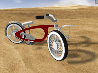

Scale the frame |
