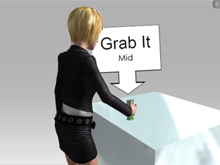

Grab

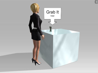

First take the Grab_It_Mid_Dummy as an example.

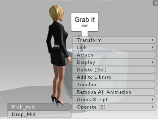

  1. Please drag and drop Grab_It_Mid_Dummy to adequate height. (Z = 104 is the best choice)
  2. Right click on the dummy and select Operate/Pick_mid.
The actor walks to the side of the dummy and pick it up.

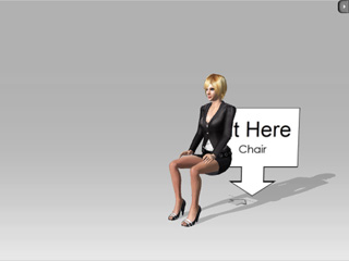

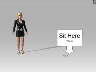

In this section, we will take Sit_Here_Chair_Dummy as an example.
  1. Please drag and drop Sit_Here_Chair_Dummy to desired location, be aware that the small arrow indicates where the actor will move to.
  2. Right click on the dummy and select Operate/Sit_Down.
The actor walks to the pivot of the dummy and sits down.

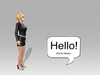

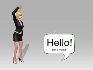

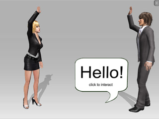

    Here we use the Hello dummy as an example.
  1. Drag and drop the Hello from the Prop/AML Template/Character_Interaction library.
  2. Pick the actor as the Active Actor and then right click on the dummy.
  3. Select Operate/Hello in the right-click menu. The actor will start to wave his/her hand.

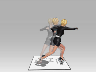

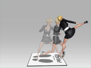

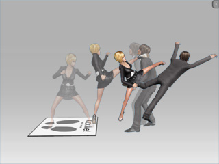

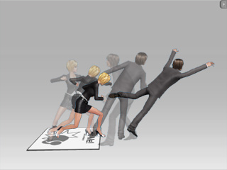

  4. The motion clip will then be inserted into the Operate track of the actor. You may also utilize the Hit_Me_Kick_Dummy or Kick_Me_Punch_Dummy to have the actor do kicking or punching motions.
Hit_Me_Kick_Dummy
Kick_Me_Punch_Dummy

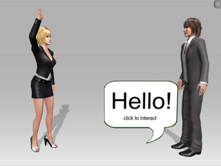

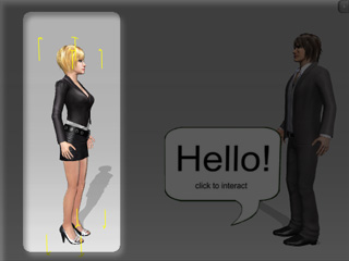

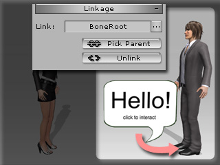

    If you want to have two actors interact with the dummy, a few more steps are necessary to achieve that goal. We will still use the Hello dummy in our example:
  1. Drag and drop the Hello dummy from the Prop/AML Template/Character_Interaction library.
  2. Select the dummy and Link to the Reacting Actor.
  3. Pick another actor as the Active Actor.
  4. Right click on the dummy and select Operate/Hello in the right-click menu. The active actor starts to wave his/her hand and later the reacting actor will wave back.
  5. The motion clips will then be inserted into the Operate tracks for both actors. You may also utilize the Hit_Me_Kick_Dummy or Kick_Me_Punch_Dummy to have the two actors do kicking or punching motions.
Hit_Me_Kick_Dummy
Kick_Me_Punch_Dummy
Note:
  • To set the right path for character interaction, please keep the text side of the interactive dummy to the Reacting Actor and the graphics icon side to the Active Actor as shown in the sample above.
  • If you are satisfied with the result, you may remove the dummy, or set its Opacity to 100 to hide it from being rendered.
  • The adequate distance between the interactive dummy and the Reacting Actor is 100 units for the punch dummy and 200 units for the kick dummy.
