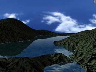

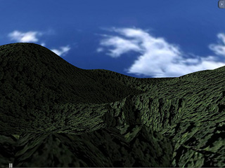

In the Basic Water Parameters section, adjust the value to see the changes.
Press Play to see the result.
![]() Before Water Applied |
![]() After Water Applied |
You may use Ctrl - F7 to turn on/off the effect of water, or go to Modify page to uncheck the effect of Reflection and Refraction to decrease the loading of your system resources.
