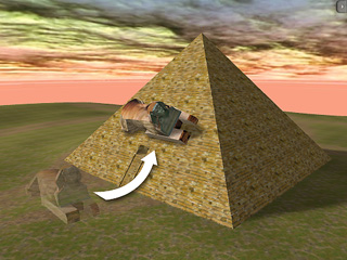

Apply one prop (Pyramid) to the project. Right-click on it and select Add to Terrain.
In the Scene Manager, pick the prop under the Terrain entry.
Go to the Terrain Component section of the Modify page. Uncheck the Use Bounding Mesh box.
Apply another prop (Sphinx) and drag across the terrain to see the result.
Check the Use Bounding Mesh box. Drag the prop across it again and see the different result.
Use Bounding Mesh = OFF |
Use Bounding Mesh = ON |

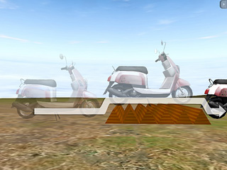

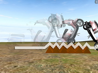

This feature is useful if you want to utilize the Follow Terrain or
Snap to Terrain function in
