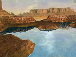

Go to Set/Terrain, in the Content Manager/Template tab, apply the desired terrain template into the 3D viewer as the base terrain.

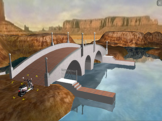

Apply props that you intend to be part of the terrain from the Template or Custom library.
Right Click on the props individually and select Add to Terrain in the right-click menu .
Press down the
button
and use move tool to move your actor or iProp over the terrain.
Watch as it follows the contours of the terrain, including the
bridge in the example below.
Select the prop for moving |
Use the move tool to move it and it will |
