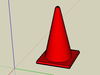

Create Model in SketchUp. The pivot of the model is set at the origin. |

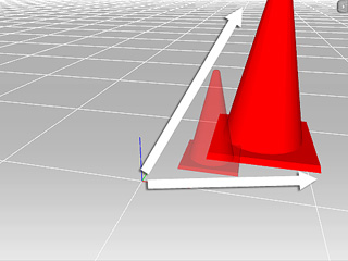

Since the pivot is the base for the transform data to refer to, the Move, Rotate and Scale work according to the pivots of objects. If a pivot is outside of the model entity, the unexpected result happens, especially Rotate and Scale, when you adjust the transform data of the object.

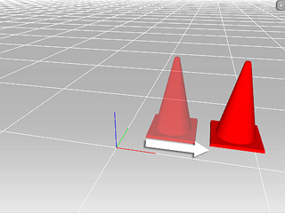

Move |

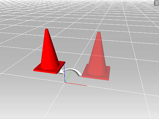

Rotate |

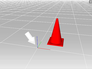

Scale |
