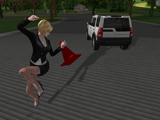

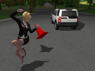

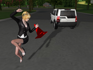

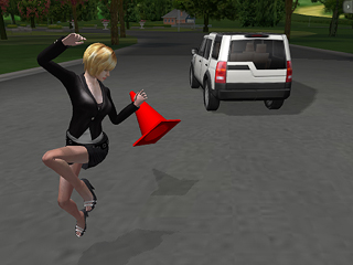

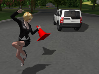

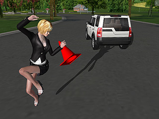

In the Shadow Type drop down list, you may decide to turn the shadow effect to None/Self-Cast Shadow/Drop Shadow/Wall Shadow:

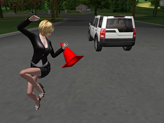

None |

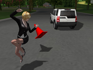

Self-Cast Shadow (Directional Light) |
Self-Cast Shadow (Spotlight) |
The Shadow is turned off. |
The Shadow is turned on with directional light. |
A realistic way to calculate the physical |

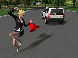

Drop Shadow |

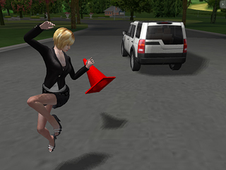

Wall Shadow |
A quick way for characters to drop shadow |
Wall Shadow shows an offset shadow directly |
More about Self-cast Shadow
Spotlight cast best self-cast shadow because of restricted effect range, keep the best shadow map resolution.
The stronger light may cast higher opacity shadow, especially the directional light.
Higher resolution shadow map is required if you wish that all scene elements to cast shadows.
Self-cast shadow can only be projected on 3D objects but not on the virtual floor (X-Y plane) or 2D space.
If self-cast shadow casts on objects with alpha transparency effect, it might cause some artifacts.
Adjust the Opacity value may define the transparency of the shadow. Basically, the stronger light casts higher opacity shadow, especially the directional light
