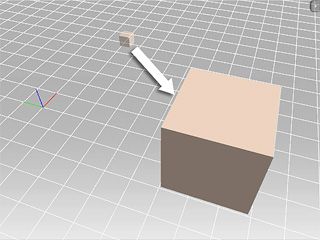

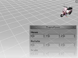

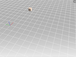

Apply one regular prop and open its Transform track. The current transform data is added into the first frame in the track.

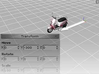

Go to desired frame, add one key by moving, rotating or scaling the object.

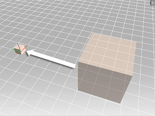

Go to another frame later than the key added in step 3. Click the Zero Transform Key. iClone will then add a neutral key to cancel the effect of previous keys.

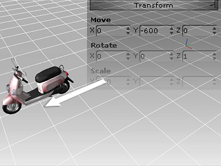

In the timeline, apply a motion clip to the Move track select the Transform track.
Go to desired frame, set one Transform key to tune the transform data which effects the Move motion.

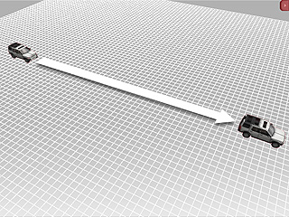

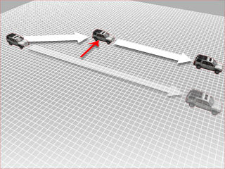

The original moving path of the iProp.
Moving animation is saved in the |
A transform key (offset along the X axis) The path is modified by the transform key. |

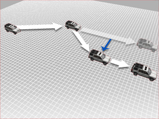

Go to another frame. Click the Zero Transform Key. iClone will then add a neutral key to cancel the effect of all the previous keys in the track.

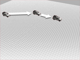

When the car moves to the location |
A new Zero Transform Key key neutralizing The path is back to the original one. |
