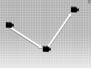

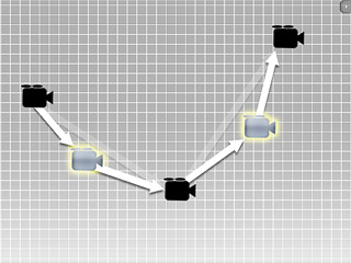

Since iClone interpolates between two keys (especially for the Transform keys) in a linear method so a camera's path may not be smooth enough for your liking. Using the Smooth Camera Movement feature will have iClone insert transform keys to make the camera move on a curve-like path.
The illustrations below describe the path before/after the Smooth Camera Movement feature is applied.
Before Smooth Camera Movement.
After Smooth Camera Movement.

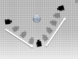

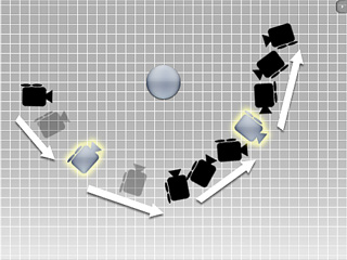

Since iClone interpolates between two transform keys using a linear calculation you may sometimes find an unexpected rotation of the camera after you apply the Smooth Camera Movement, especially when the transform data of the camera involves Rotation.
  • Rotate Keys Involved.
  • Before Smooth Camera Movement.
  • After Smooth Camera Movement.
  • Camera Rotates Unexpectedly.

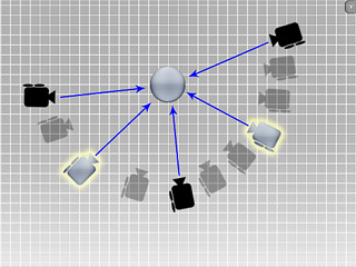

  • It is highly recommended to make the camera Look At the target to prevent this behavior because the Look At feature will fix the camera on your desired target even during movement.
