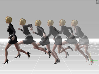

You may notice that sometimes the actor moves away as we apply an animation to it. You may want to modified this motion and make it a custom one to be used later as Perform, Walk, Operate motions. To achieve this goal, it is better to have the whole motion to happen in the same position. You may then utilize this feature to prevent from setting the pose back to the same location manually frame after frame.

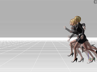

Select this motion clip in the Perform track. Click Reset Motion Pivot button. The whole motion then happens at the same position.
