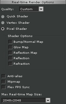

iClone supports three levels of shader for real-time rendering: Quick, Vertex and Pixel Shader and automatically detects the 3D graphics card installed in the PC and provides available Quality options. The Quality setting is dependent on the 3D graphics card installed on the PC. For example, with Nvidia 7x00 series or ATI Radeon 9x00, users can select High, Middle, Low and Custom render settings. However, with older 3D graphics card such as Geforce4 MX that do not support shader model 1.0, users can only select Low and Custom options. The new Pixel Shader function will be disabled if the requirement is not met.
The Quick Shader produces an efficient real-time render with most 3D effects disabled for faster performance.
The Vertex Shader disabled some of the 3D effects to have medium visual quality.
The Pixel Shader takes advantage of shader model 1.0 and has options including: Bump/Normal, Glow, Reflection Map, Reflection, Refraction. Turing these options on increases the visual quality but consumes system resource.
Please refer to the Shading Methods of 3D Viewer section for more information.

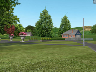

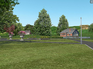

An anti-aliased output will produce a smooth image with less jagged edges and pixilated areas. Check the box to turn the Anti-alias feature on.
Anti-alias Off |
Anti-alias On |

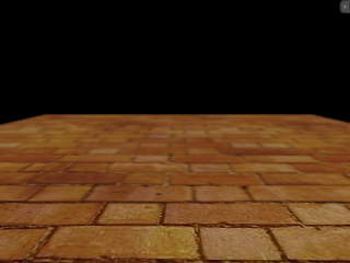

The Mipmap force to render object with gradually-lower-resolution texture along with the distance.
Mipmap Off |
Mipmap On |
As the camera angle turns to be too oblique, MipMap feature may cause some surfaces that are near the camera blur. To compensate the disadvantage, you may increase the Anisotropic value to gain more mapping quality.
Anisotropic Off |
Anisotropic = 16x |
