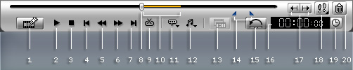

The play bar is used to control the real-time playback of iClone scenes.
1 |
Editor/Director Mode |
To toggle between Editor Mode and Director Mode. |
2 |
Play |
To play back current project. |
3 |
Stop |
To stop playing. |
4 |
Jump to Start Frame |
To jump to the cue in frame of the playback range or the start frame of the whole project. |
5 |
Previous Frame |
To jump one frame backward. |
6 |
Next Frame |
To jump one frame forward. |
7 |
Jump to End Frame |
To jump to the cue out frame of the playback range or the end frame of the whole project. |
8 |
Play Head |
Shows the current frame of the project. You may also drag it to any desired frame quickly. |
9 |
Loop On/Off |
To toggle playback loop on/off. |
10 |
Action Segment |
Highlights the existing or recorded clips of animation. |
11 |
Vocal Volume |
To adjust the volume of the sound effect. |
12 |
Music Volume |
To adjust the volume of the background music. |
13 |
Show Timeline |
To evoke the Timeline (Pro Version Only). |
14 |
Mark In/Out of Playback/Export Range |
Drag this mark to set the mark in/out frame for playback or exporting. |
15 |
Reset Project Animation |
Click this to Reset all recorded animation data for this session. |
16 |
Current Time |
To show the current time/frame. |
17 |
Action Tabs: Next & Previous |
To move the Play Head to the beginning or the end of each Action Segment. |
18 |
Action Track Selector |
To switch to another track in the list. Please see Play Bar and Tracks section for more information. |
19 |
Use the Time Setting panel to set the total length of the current project and the time unit to be shown in the Current Time box. |
20 |
Delete |
To delete the current Action Segment. |
