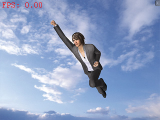

FPS (Frames Per Second) indicates the rendering performance of your system with the current project.
Check/Uncheck the FPS box to show/hide the Frames Per Second information on the 3D viewer.
Alternatively, you may press Ctrl - F to toggle FPS on/off.

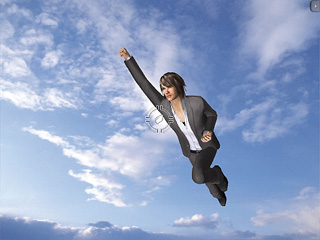

The Crosshair in Walk/Fly Camera Mode may show the crosshair in the center of the 3D viewer to indicate if your camera is in Walk or Fly mode.
Check/Uncheck the Crosshair in Walk/Fly Camera Mode box to show/hide the Crosshair on the 3D viewer when the camera is in walk/fly mode.
Alternatively, you may press Ctrl - U to toggle the crosshair on.
Fly Camera Mode |
Walk Camera Mode |

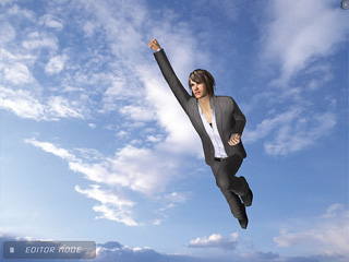

The Editor/Director Mode may show the mode name at the bottom of the 3D viewer to indicate if you are in the Editor or Director mode.
Check/Uncheck the Editor/Director Mode box to show/hide the mode name, or press Ctrl - Q to toggle on/off.
Editor Mode |
Director Mode |

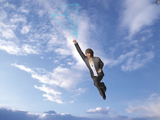

The Pointer in Director Mode places a pointer on the selected object in the Director Mode.
Check/Uncheck the Pointer in Director Mode box to show/hide the mode name.
Alternatively, you may press Ctrl - I to toggle the pointer on/off.

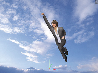

When the World Axis box is on, a coordinate displays in the origin. It is very useful when you need to input x, y, z value, or create custom Helper.
Check/Uncheck the World Axis box to show/hide the world axis, or press Ctrl - A to toggle on/off.
The R.G.B. color of the World Axis represent the X, Y, Z direction (R=X, G=Y, B=Z)
