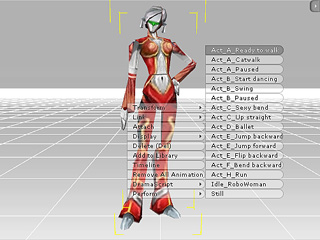

You may right-click on the prop and select the animations in the Perform list.

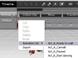

If you are using the iClone Pro version, you may also open the timeline, choose the Perform track of the LiveProp and right click at the desired frame and pick one of the animations from the Animation List.
Right-click on the LiveProp and select |
Right-click on the Perform track. |
