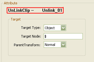

UnLink Clip
When an unlink clip is
selected, the clip type and the selected clip name will be shown on the
top left of the "Attribute" section.
When you have selected one
of the unlink clips, the available attributes for the selected unlink
clip shows below. Adjust each of the settings to set the parameter of
selected unlink clip. The "UnlinkClip" unlinks the target node.
Target Type: This sets the type for who will be able to
trigger the parent type (iProp).
Character |
The target character
will be affected by this animation clip. |
Object |
The target object
with embedded animation clip. This prop will then be
defined as interactive prop, iProp. |
Rider |
The character who is
riding on the motorcycle or driving the car will be
affected with this motion. |
Owner |
The character who
has linked to an iProp. |
Target Node: This "$" defines the object itself. If
there is a child attached to the parent, it will be defined as $
sign followed by ".child". So it will look like this "$.child".
ParentTransform:
Sets how you are unlinked to the parent node.
Normal |
When you are linked,
the target node's position will not change. |
Align |
the target node's position is aligned to parent node's
position, but the angle will remain the same. |
Snap |
the target node's position and angle both aligned to the
parent node. |
