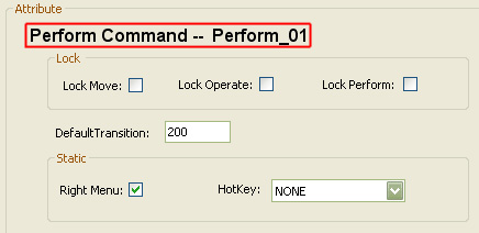

Perform Attribute
When you have a perform
command selected, the command type and the selected command name will
shown on the top left of the "Attribute" section.
When you have selected one of
the perform commands, the available attributes for the selected perform
command shows
below. Adjust each of the settings to set your perform command.
Lock Move |
When this is active,
this does not allow other move commands to interrupt. |
Lock Operate |
this does not allow other operate command to interrupt while
move is in progress. |
Lock Perform |
this does not allow other perform command to interrupt while
Default Transition:
This sets the transition time between the two operate commands to blend.
Right Menu:
When this is checked you defines
that the selected command should appear in the right-click menu in iClone3.
HotKey: These
hot keys are assigned for you to use it in Director Mode.
NONE |
No hot keys
are
assigned to the perform. Only available in Director Mode. |
Perform 1~60 |
Assign any of
the hot keys from Perform1 to Perform60. This allows you to
use the hot keys in Director Mode. |
