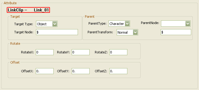

Link Clip
When a link
clip is selected, the type of clip and the selected clip name will
be shown on the top left of the "Attribute" section.
When you have selected
one of the link clips, the available attributes for the selected
link clip shows
below. Adjust each of the settings to set the parameter for the selected
link clip.
- Target Type:
This sets the type of who will trigger the parent type (iProp).
Character |
The target character
will be affected by this animation clip. |
| Object |
The target object with
embedded animation clip. This prop will then
be defined as interactive prop, iProp. |
| Rider |
The character who is
riding on the motorcycle or driving the car will be affected
with this motion. |
| Owner |
The character who has
linked to an iProp. |
- Target Node:
This "$" defines the object itself. If there is a child
attached to the parent, it will be defined as $ sign followed by
".child". So it will look like this "$.child".
ParentType: Sets the on/off switch for the selected particle
clip.

ParentTransform:
Sets how you are linked to the parent node.
| Normal |
When you are linked, the
target node's position will not change. |
| Align |
target node's position is aligned to parent node's position,
but the angle will remain the same. |
| Snap |
target node's position and angle both aligned to the parent
node. |

RotationX |
When link is in
progress, it offsets the X axis rotation. This corrects the
X axis rotation. |
RotationY |
When link is in
progress, it offsets the Y axis rotation. This corrects the
Y axis rotation. |
RotationZ |
When link is in
progress, it offsets the Z axis rotation. This corrects the
Z axis rotation. |
| OffsetX |
When link is in
progress, it offsets the X axis on translate. This corrects
the X axis rotation. |
| OffsetY |
When link is in
progress, it offsets the Y axis on translate. This corrects
the Y axis rotation. |
| OffsetZ |
When link is in
progress, it offsets the Z axis on translate. This corrects
the Z axis rotation. |
