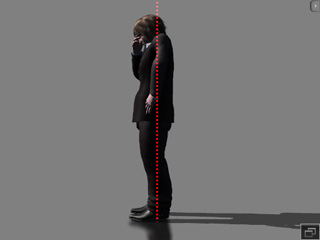

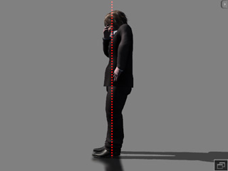

Straightening the Leaning Body

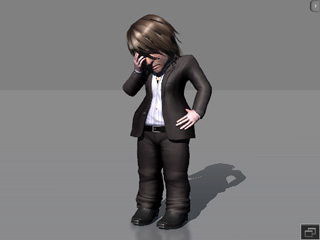

Load a G3 character into iClone.
The G3 character leans backward as you apply motions to it.

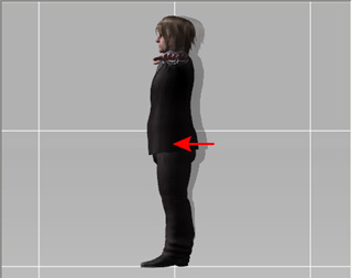

Go to 3DXchange. Load the character.
Go to the Character (Shortcut: N) section and click the Adjust Standard Bone button.
Switch to the Property tab in the Characterization Mode.
Adjust the Hip Offset value for the character to prevent it from leaning.
It is highly recommended that you activate the Auto check boxes for
Spacing and Height in the Feet Offset section
(3DXchange will measure the optimized values for the character).
However, if you want to manually set the values, deactivate the box and type in the desired values.
Click the Convert button to save the adjustments to the character.
Export the character as a Standard Character to iClone (Shortcut: Ctrl + E).
(You may optionally click the Apply to iClone button to quickly replace the selected character
in iClone with the re-converted one)
Apply the re-converted character and apply any motion. The leaning issue is eliminated.

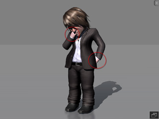

Load a G3 character into iClone and change its body proportion.
The character's body proportion is adjusted.
Apply a motion. The limbs may penetrate the body.

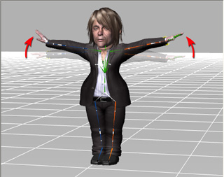

Deactivate the Active box, select the bones that
are causing the penetration issue, and then modify the angles of the bones.

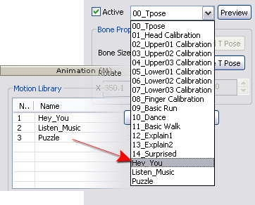

Activate the Active box and preview the motion result by selecting
motion templates from the Preview drop-down list.
Note:
You can directly preview the motions in the Motion Library
(either from the embedded motions of an iAvatar or from any FBX files)
from the Preview drop-down list during the
characterization procedure before pressing the Convert button.

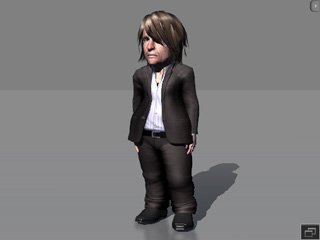

Click the Convert button.
Click the Apply to iClone button to send the character back to iClone. The
penetration issue is then solved.
