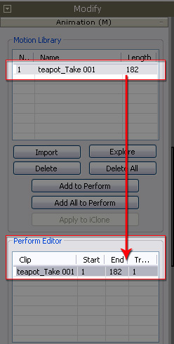

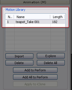

  1. Load a model file of the format described above with Transform animations. The animation will be listed in the Motion Library. You may select the animation in the list and click the Play button to see the transform animation.
  2. 3DXchange will automatically add this animation into the Perform Editor.
  3. Click on the Start or End fields of the item in the Perform Editor and type in the frame numbers to assign a range for this item.
    Alternatively, you may use the mark in and mark out triangles under the time slider to form the range.
  4. Click the Add to Perform button in the Motion Library to add the animation into the Perform Editor again.
  5. Repeat last steps until the original animation is split into different animation clips.

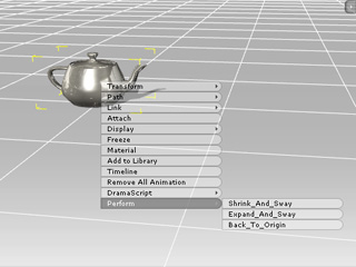

  6. Export (Ctrl + E) the model as an iProp (.iProp).
  7. Load into iClone. Right click on the iProp and all the animation clips you have added will be listed in the Perform entry of the right-click menu.
