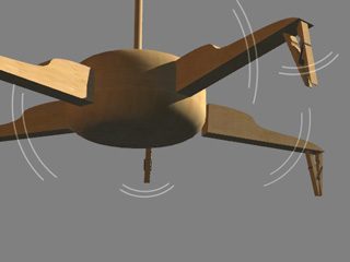

Adding Spring Effects to Props (New for 5.4 and for Pro only)
By adding spring effects to specific parts of a prop, the resulting bouncing effects result in a more dynamic and realistic animation. This pipeline is suitable for any bone-skinned model from other 3D tools or merged models constructed in iClone.

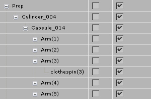

    Build Structured Props in iClone
    1. Attach each transformed (or not transformed) part to single main root prop.
      Sequentially attaching.
      The structure in the Scene Manager (Single root only).

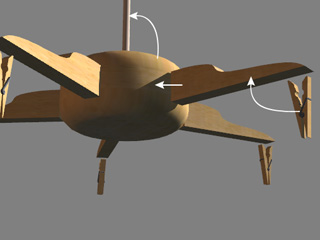

    2. Select the root prop and scroll to the Transform section in the Modify page.
    3. Click the Reset Scale to initialize the size for all sub-nodes to prevent structure distortions.
    4. Scroll to the Attach section of the Modify panel. Click the Merge button.
      After being given spring effects.

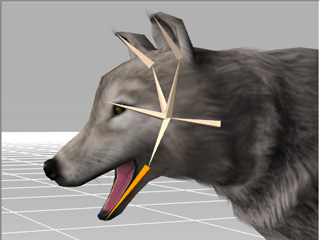

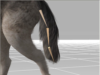

  2. Scroll to the Spring section and click the Edit Spring button.
  3. The Modify panel will switch to Spring Editing mode.
  4. Select the bones to which you want to apply spring effects to, then click the Active Spring button and adjust the spring parameters.
    In this example, the head and the tail bones of the prop have been given spring effects.

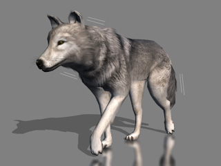

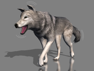

  6. Load into iClone. Animate the prop to view the spring effects

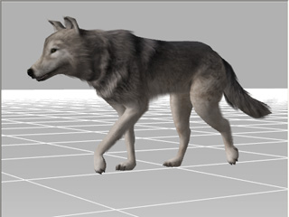

    The prop without spring effects.
    The prop with spring effects.
