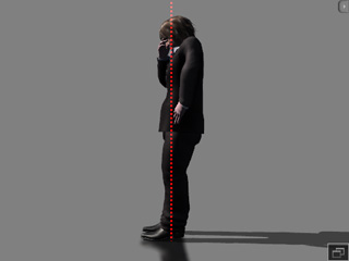

The G3 character leans backward as you apply motions to it.

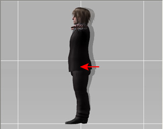

Go to the Character (Shortcut: N) section and click the Adjust Standard Bone button.
Switch to the Property tab in the Characterization Mode.
Adjust the Hip Offset value for the character to prevent it from leaning.
It is highly recommended that you activate the Auto check boxes for
Spacing and Height in the Feet Offset section
(3DXchange will measure the optimized values for the character).
However, if you want to manually set the values, deactivate the box and type in the desired values.

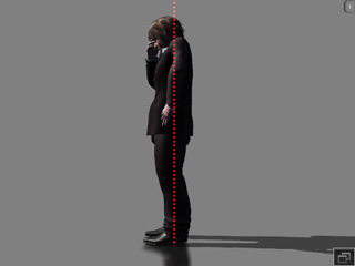

Apply the re-converted character and apply any motion. The leaning issue is eliminated.

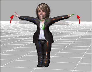

Modifying Standard Character with Adjusted Body Proportion
In addition to rectifying the leaning issue, you can also use this feature to modify the character's
T-pose in order to prevent the penetration of the limbs to the body, especially
after the character's body proportion has been changed.

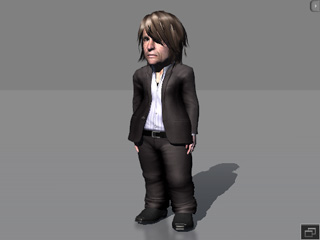

Load a G3 character into iClone and change its body proportion.
The character's body proportion is adjusted.

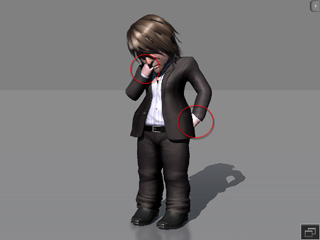

Apply a motion. The limbs may penetrate the body.
Select the character, go to the Actor >> Avatar >> Modify page
and click the Edit in 3DXchange button.
Deactivate the Active box, select the bones that
are causing the penetration issue, and then modify the angles of the bones.
Activate the Active box and preview the motion result by selecting
motion templates from the Preview drop-down list.

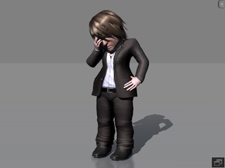

Click the Convert button.
Click the Apply to iClone button to send the character back to iClone. The
penetration issue is then solved.
