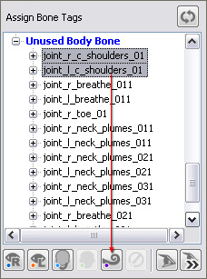

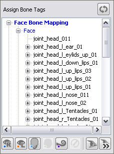

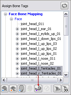

After you map the body bones and activate the mapping result, the head bone of the character is determined; and all child bones of the head bone will be initially treated as facial bones. Aside from the bones that are mapped as eyes and jaw, any other additional bones can be mapped to the Facial Extended Bones category for manual adjustment in iClone.
After you map the body bones and activate the mapping result, some spare bones may be left out of the mapping procedure. These bones will be put into the Unused Body Bone category in order to simplify the bone edit view when you use the IK/FK motion tools on the character the character in iClone by hiding these redundant bones. However, these bones can all be mapped to the Body Extended Bones category if you need any of them to be animated later.

The two spared hands are able to be animated in iClone. |
The two tentacles are also able to be animated in iClone. |
