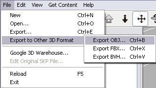

Execute the File > Export to Other 3D Format > Export OBJ...
command.
