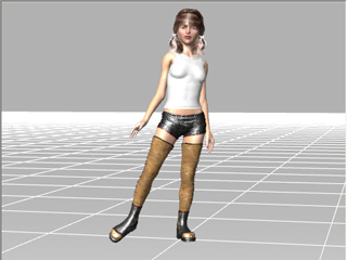

Step 1: Loading a Bone-Skinned Model
A bone-skinned model contains a bone structure and one or more meshes, while the meshes are
bound to the bones so that when the bones move or rotate, the meshes are
driven to
act along with the bones.

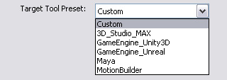

In the Export FBX panel, use the Target Tool Preset drop-down list to auto-set the settings
for Maya or 3DS Max.
Please refer to The Settings for Exporting an FBX File section for more information
about the details of the settings.
Click the OK button to export the model in FBX format.

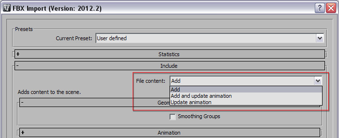

Step 3: Loading and Setting the Key-frame Animations in Maya or 3DS Max
Import the FBX file into Maya or 3DS Max
with the settings below:

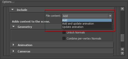

Maya (FBX plugin 2012.2 version or above)
Select the Add item from the File content drop-down list
in the Include section.
Please refer to the
Adapting iClone Characters for Maya Human IK section for more information
about adapting iClone standard or non-standard characters to Maya
for performing key-frame animation with Human IK Rig method.
3DS Max (FBX plugin 2012.2 version or above)

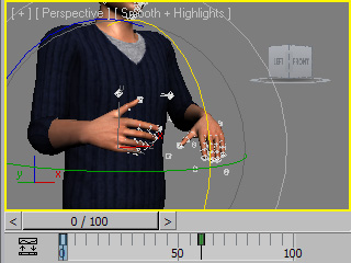

Adjust the bones to change the position of the model at different time frames and set keys to the bone structure.
Play back to view the time-frame animation.
