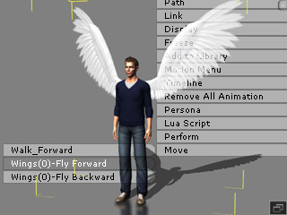

Step 1: Preparing Character and Animated Accessory (in iClone)

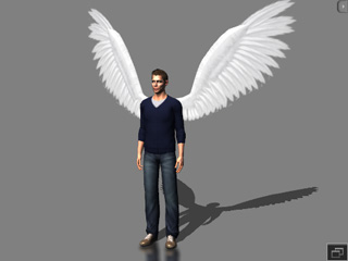

  1. Load a character in iClone.

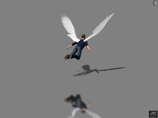

  2. Drag and drop an accessory to the character (The wings, for example).
  3. Right click the character and select Move >> Flying Forward command. Click on the ground to have the character fly to the destination (make it far if you want the accessory to animate longer).
  4. Click the Add button to add the character with the animated accessory into the Actor custom library.

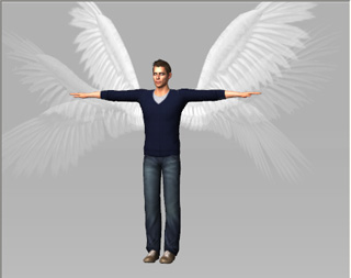

  1. Make sure the character is selected.
  2. In iClone, go to the Actor >> Avatar >> Avatar section, click the Edit in 3Dxchange button to load the character into 3Dxchange.
  3. Alternatively, you can drag and drop the character template added in the last section.
  4. Click the Play button and the accessory will start to animate.

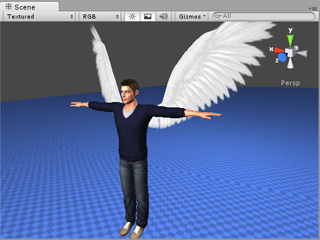

Step 3: Exporting in FBX Format
  1. Press Ctrl + X to start to export the character with the accessory.
  2. According to the target 3D tool for re-using the character, select the corresponding preset from the Target Tool Preset drop-down list.
Step 4: Loading the Character into 3D Tools
The character, accessory and their motions are now exported in the FBX file. You may use the file in other 3D tools (Unity for example).

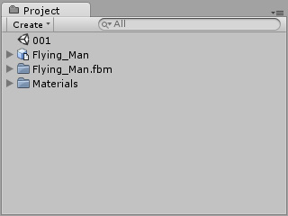

  1. Load the character to the assets library.

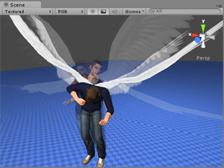

  2. Drag and drop the character to the scene.
  3. Click the play button to start the game mode. The character starts its idle motion with the animated accessory.
