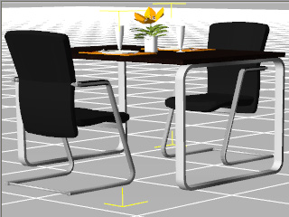

To convert model to static prop
  1. Load a model file in the format described above.
  2. Optionally modify the nodes of the model:
  3. Export (Ctrl + E) the entire model as one single prop (.iProp).

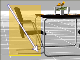

To separate mesh from the model after conversion
If you want to have one or more specific mesh nodes seen or transformed in iClone, please follow the steps below:
  1. Load a model file of the format described above.
  2. Select the node to be dissect in the Scene Tree.
  3. Make the node as a sub-prop.
  4. Optionally edit the pivot of the sub-root node.

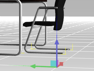

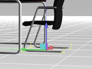

    Eccentric Pivot
    Bottom-centered Pivot
  5. Repeat step 3 and 4 until all the target mesh nodes are turned to sub-nodes.

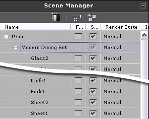

  6. Export (Ctrl + E) the model as a prop (.iProp).
  7. Load into iClone. You may then see all the nodes in the Scene Manager.
