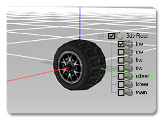

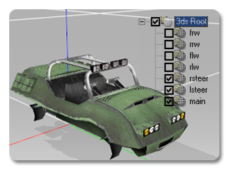

Exclude the car wheels by un-checking the wheel node boxes in the Scene Tree.
(In 3DXchange)

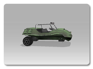

Export the Car body to iClone as a Prop VNS.
Select one car wheel and reposition using the Align to Center pivot command 0,0,0. Exclude the rest of the car.

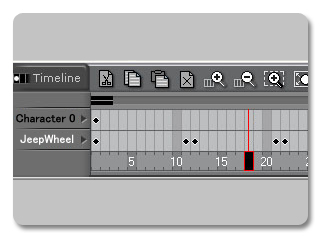

Create the wheel spinning motion using the Adjust tools in the Modify panel and keep the wheel spinning by making key frames on the Timeline controlling the speed and duration of the wheel spin.

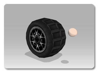

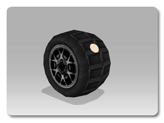

Add a Ball Prop from the Prop 3D Blocks to the scene.
(In iClone 2)
Move and place the ball completely inside the wheel to hide it.

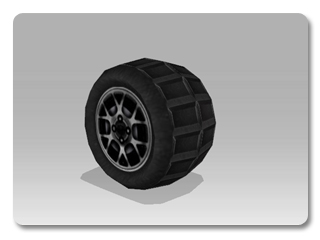

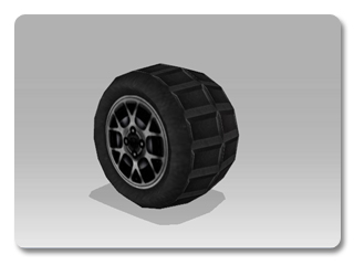

Move and hide the ball (In iClone 2) |
The ball is hidden (In iClone 2) |
Merge the wheel and the ball. The merged prop is now containing a motion clip of spinning.

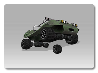

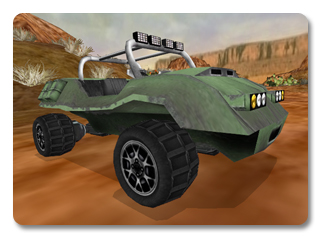

Add the body of the car to the scene. Apply the spinning wheel in the custom library.
(In iClone 2)
Now add 3 other wheels to the scene and position them accordingly
(In iClone 2)
In the timeline, set the duration of rotation clip for each wheel.
Merge the entire props visible as one merged prop and add it to your custom prop library.
The new merged prop can be move to anywhere in the scene with spinning wheels.
