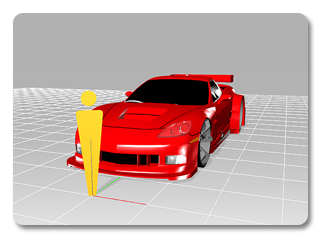

Original Size |
Scaled Along X Axis |

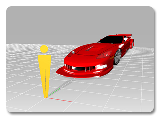

Scaling Y - Click the up arrow to increase the value of the scene orientation and click the down arrow to decrease it around the Green Axis. You may also key in the value into the edit box to rotate the scene.
Original Size |
Scaled Along Y Axis |

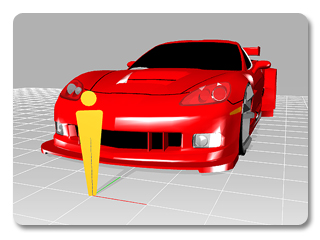

Scaling Z - Click the up arrow to increase the value of the scene orientation and click the down arrow to decrease it around the Blue Axis. You may also key in the value into the edit box to rotate the scene.
Original Size |
Scaled Along Z Axis |

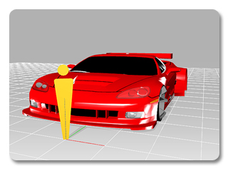

Lock XYZ - Check this box and the node selected will be scaled with the aspect ratio kept. Only the parameter for X is editable. The other two are auto-adjusted in fixed proportion along with the value of X.
Original Size |
Locked and Scaled |
