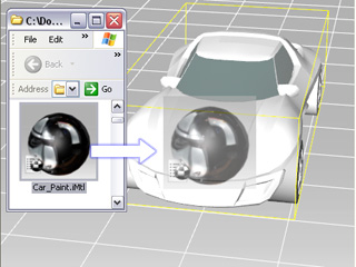

Click the Load Material button and browse the material in Windows Explorer.
iClone provides a material library in which templates, with texture settings, are optimized and ready for use. The extension for material templates is .iMtl. (You may find them in C:\Documents and Settings\All Users\Documents\Reallusion\Template\iClone 4 Template\iClone Template\Materials Lib)
Alternatively, click the Explore
button to open the
material library folder.
Switch the display mode to view thumbnail images for material templates. For applying a material, drag the selected material template file and drop onto a target node in 3DXchange.

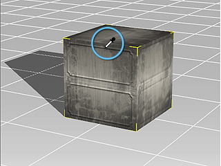

Use the Pick tool to pick the material from where you want to save the texture settings as a material template.
Click Save Material button.
Browse the destination folder to store the template.

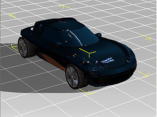

In the Select Material drop-down list, pick any material to modify.
Modify the parameters: Diffuse Color, Ambient Color, Specular Color,
Opacity, Self-illumination, Specular and Glossiness.
(For more information about the effects of these settings, please refer to the
Modifying Texture Settings - Advanced
section.)
Check the Affect All Materials to apply these settings to all the materials on the list.

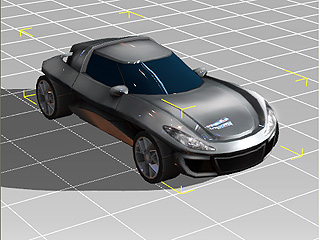

The initial appearance of the mesh. |

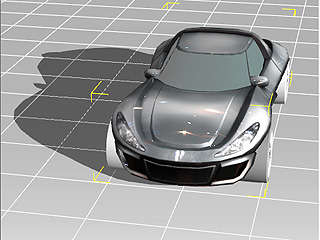

One of the materials is modified. |

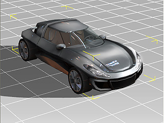

Affect All Materials: checked. |
