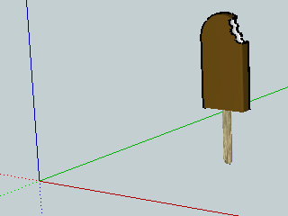

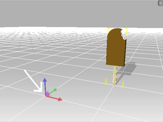

The pivot is generated automatically after you create and object via your favorite 3D modeling too (such as SketchUp). In general, the pivot is set to be located at the origin. Therefore, if you create your object away from the origin, then the pivot of it will be eccentric. iClone also loads objects with their pivots align to the world axis if you double-click to apply them.
Create Model in SketchUp. The pivot of the model is set at the origin. |
Double-click to load the model. The pivot aligns to the world axis. |
